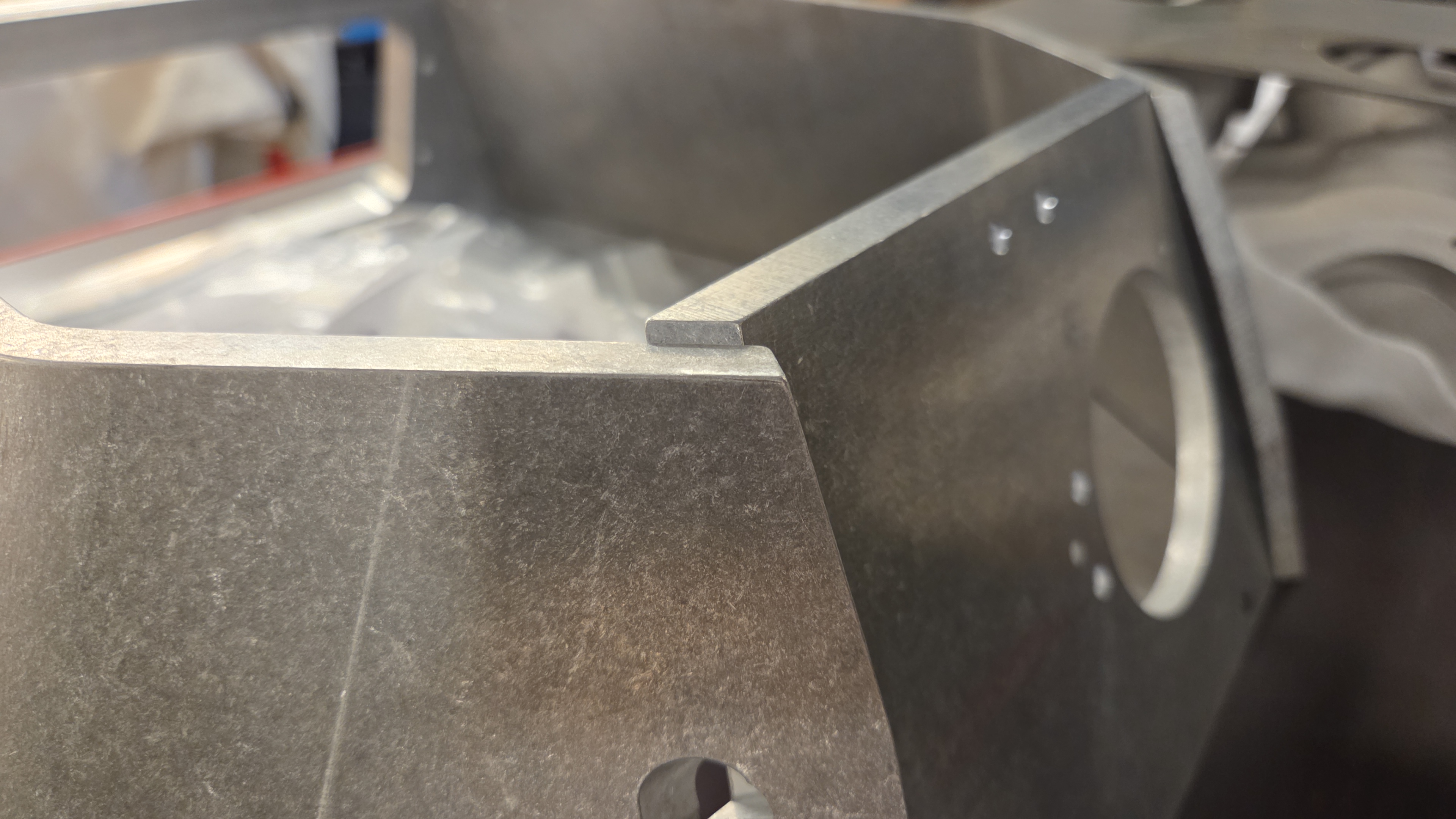

Straight out of the box, the fit of the parts was so, so. Not sure what's wrong, but the lower left corner doesn't look right:
But there are other issues as well:
Correcting the bottom plate was necessary:
...as well as the rear wall cutouts on both sides:
The cutout on the left side appeared to have been done twice at the factory - in different locations... :crazy:
This led to a rather "roomy" fit. I was trying to avoid using fillers, but this idea failed right there. :thumbdown:
The turret rear wall tabs were shortened a bit, so not to stick out through the sides. With all this now done, test assembly is next.

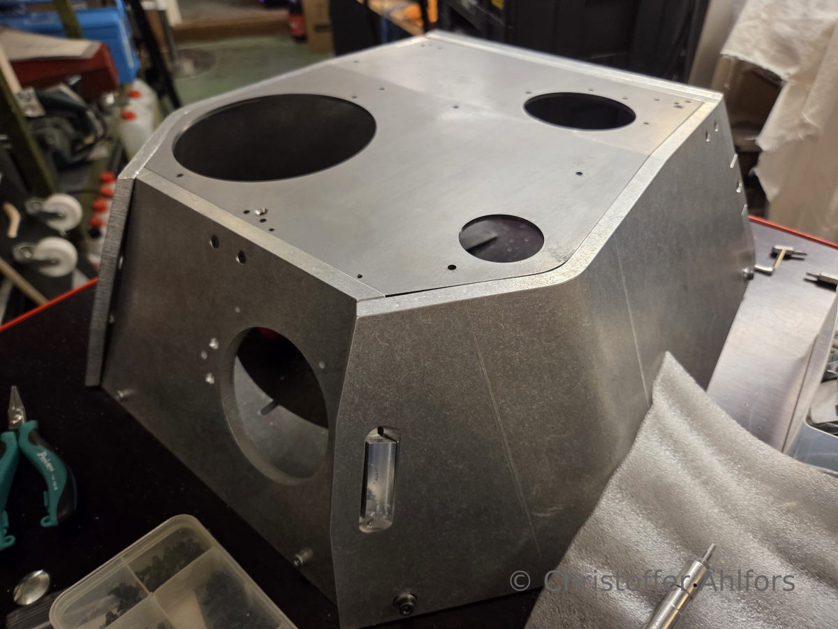

Test assembly has meant some additional milling and then some filing. The fastening screws have been upgraded from M3 to M4, since there is significant force required to pull the parts together.
I decided to leave the steel roof untouched and have adapted the turret sides to fit instead. That bit went well and now the turret looks okay in shape, without any too large gaps anywhere. The top has been prioritized to look good at the expense of the bottom, which hopefully can not be seen.
This is the result:
