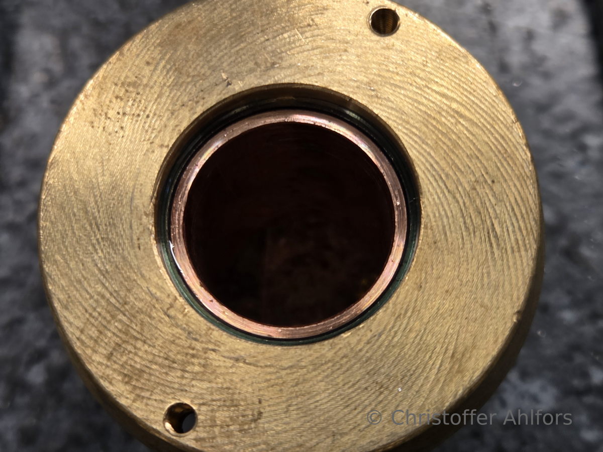

A bit of a nuisance showed itself with the idler bearings:
https://youtu.be/14qqJEuxWN8
A panther friend told me that it needs to be fixed with a bushing insert, so I looked around at the material I had to see if I could find something that could be made to fit and whaddayaknow!
Cut the tube to size and a bit of turning on the lathe:
The fit was not as tight as I aimed for, thanks to my lack of skills, therefore a bit of high strength retainer was added:
After the surgery:
https://youtu.be/pOn6doh44_Y
Happy again! :D

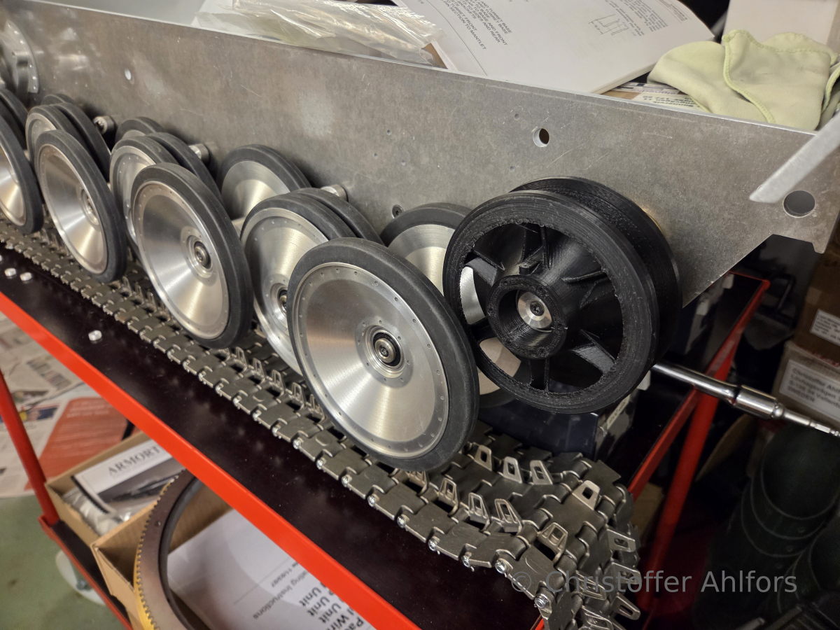

Next step is wheel alignment. It appears that the O-ring between the wheel halves takes up any axial play, while not exerting too much axial pressure on the bearings. Making a suitable "axle extension" is quite critical. A little too thin and the bearings will pinch. A little too thick and the wheel halves will move and wobble. :shock:
Posts: 1821
Re: Ahlfors' panther G
For the required increase in track horn width, I came up with parts like these. The disk is a "hub extension" and the little cylinder an axle extension. It took a few iterations to get the length of the axle extension just right, not to cause either binding or looseness:
Installed, it looks like this:
There is a larger disk for the twin wheel, but it works the same.
For the purpose of checking alignment and dimensions, a temporary idler was printed:
I had to do a little adjustment in the lathe for the bearings to fit and for the tracking to be right:
And with the track installed:
Looks like it could be the start of something:
The result:
The idler was printed in ABS with 80% infill, but it is all hollowed out because the design is actually for a steel print. This will come later. I am surprised it can cope with the rather heavy steel track! :shock:
The model is now ready for the hobby exhibition at Aeroseum in Gothenburg next weekend. OK, it's just a mockup, but it can clearly be seen how these models are constructed, which I feel is just as interesting as seeing the completed models.
