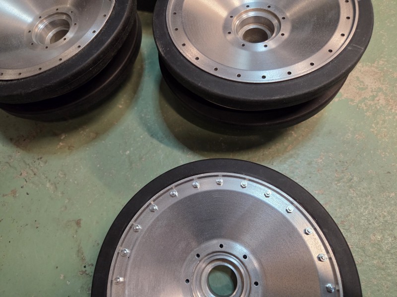

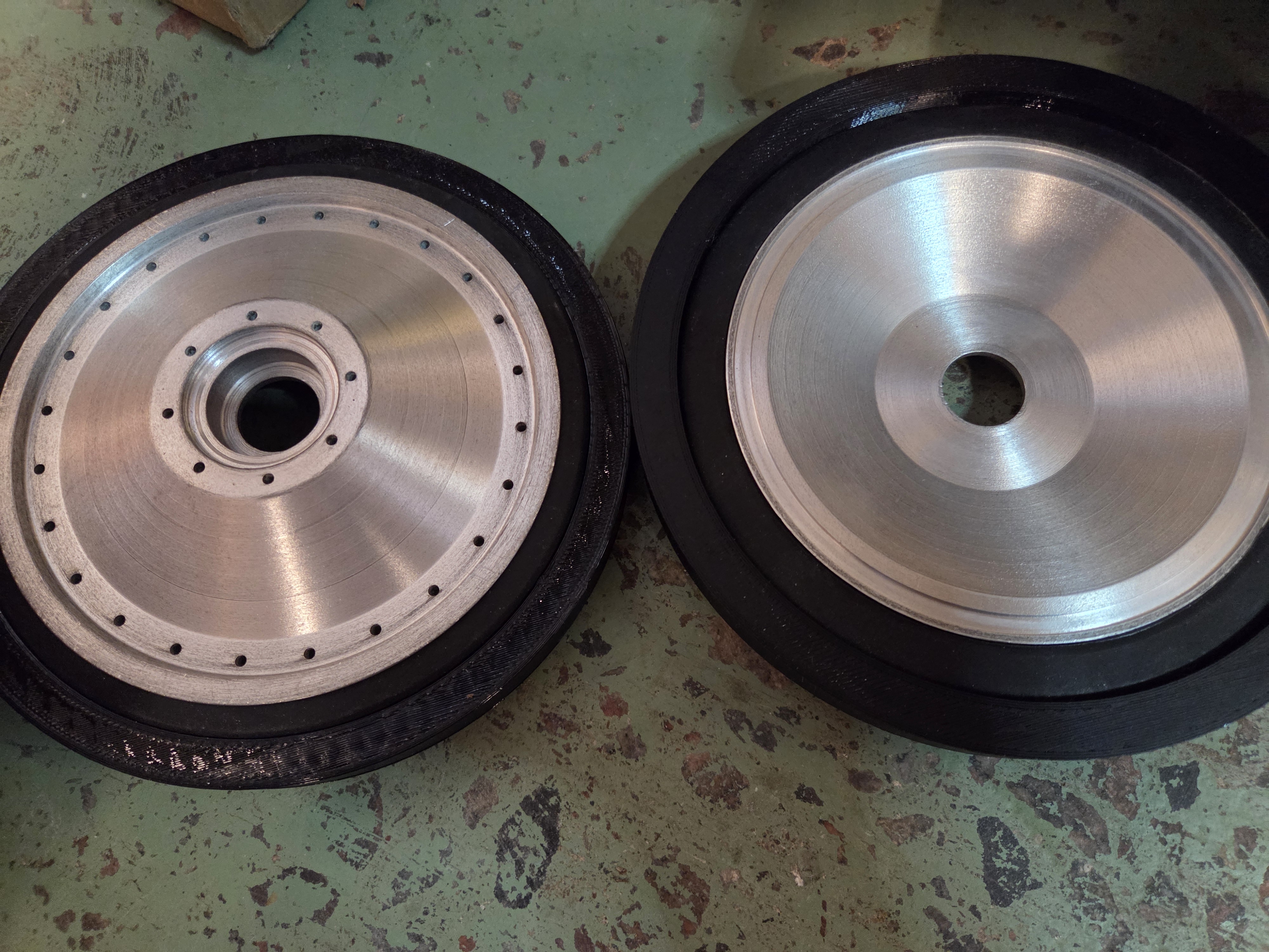

Next in line are the wheels. They are getting the rubber rings glued:
A zillion dummy studs are glued and pressed in as well:
This will keep me busy over the next few days. :crazy:
