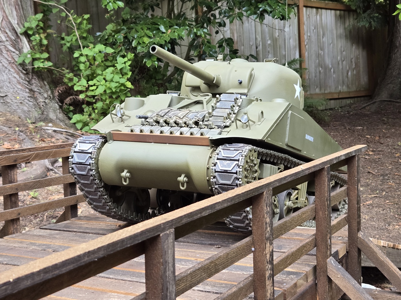

A few pics on this forum of my old M4 Sherman. I've been tinkering on this project for going on 18 years now!
May be a repeat if you saw it on Armortek forum.

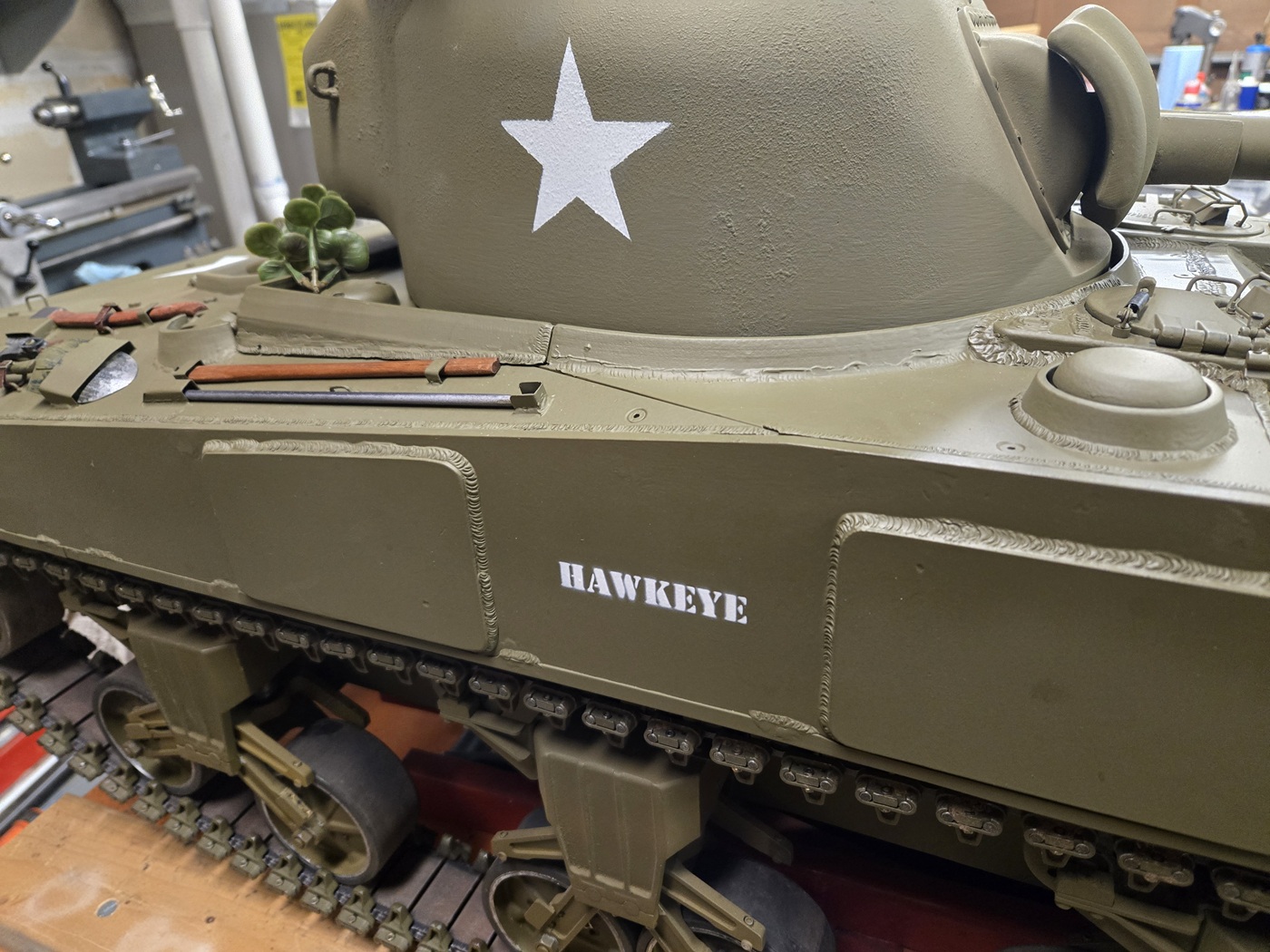

Final details added to Sherman. Tool straps using ARMORPAX buckles, names, numbers using 3D printed masks. These work surprisingly well - with two tricks required. Apply light coats with airbrush and print mask so that smooth side goes against the hull (using textured plate, print upside down). Can spray paint apply too much paint and it bleeds, but airbrush perfect - no touch up!

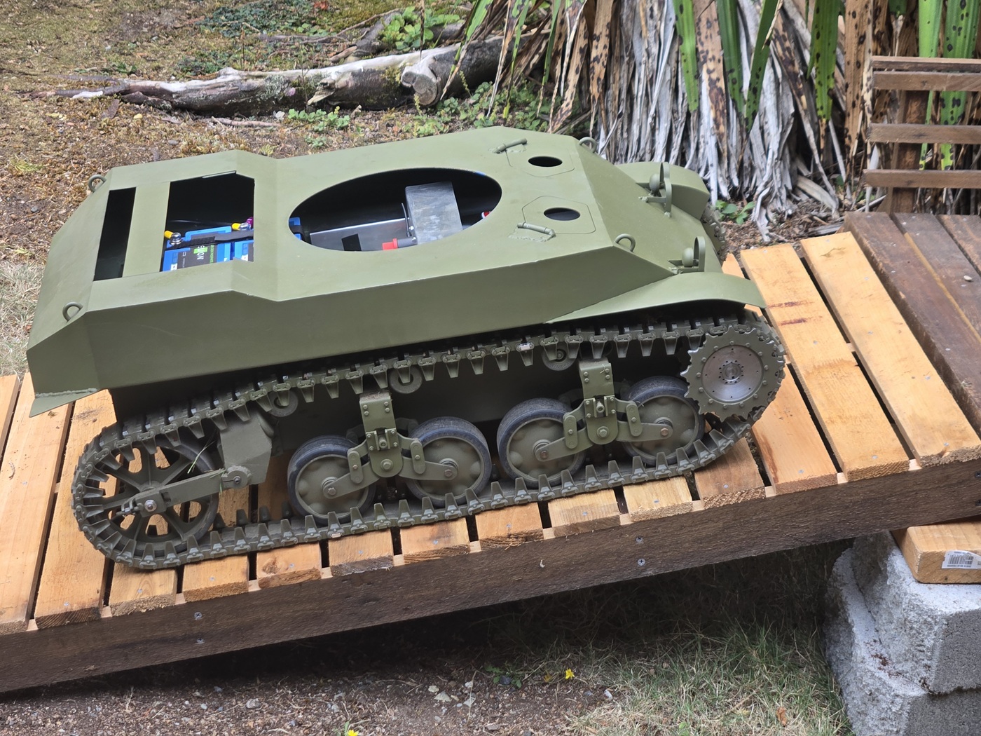

Capture the bridge day..
The Bridge. She's no Bailey or Nijmegen but still fun...
First tank to cross...
Slowly up the ramps..
Moving on...
Little Stu join the fun. But it is pretty useless with no turret. :wtf:
Headless recon tank on the bridge..
Lets head home.....
