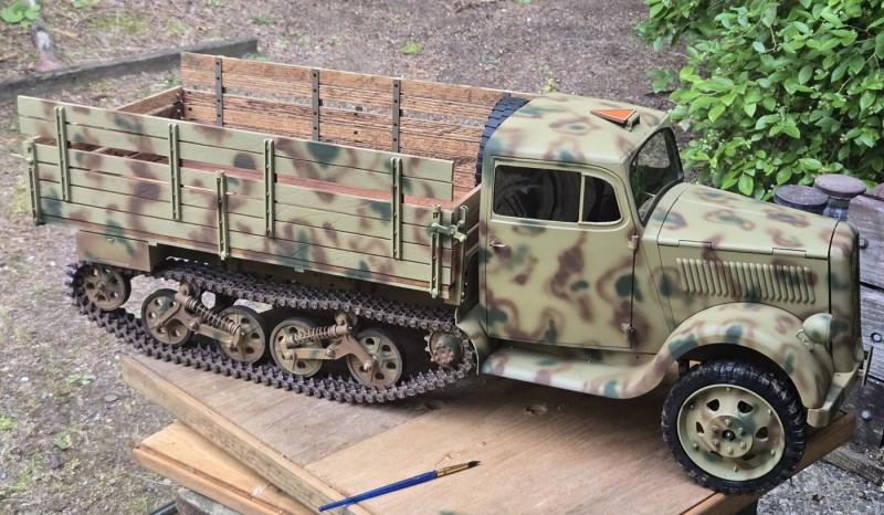

Finally got some camo on the truck, along with more mods. I like the octopus camo look! :D
Redid the front axle in metal and redesign the springs for better steering of wheels.
New axle -spring design
Right side - no barrels
With fuel barrels
With fuel barrels
Left side - Octo camo
-see you guys

The redid of the front axle is Ace work. the_man
Posts: 136
Re: Opel Maultier - Minialand57
Thanks fellas. Yeah I'm jealous of all the great get together and events you have in Europe. Getting folks together here is very difficult, partially due to distances involved. Hope to see Milltracks someday! It would be great fun to meet European tank guys (and gals).
Thanks Robert - yes the whole front end is different, including different tires, aluminum beam axle, steering knuckle, and different printed springs. I'm happy with it now, it's quite fun model. You should finish yours, I know you were disappointed by it being a bit undersize, but it's nice model overall (after mods). If you want the front end files I can give them to you. If I made it again I might print the parts at 110%.
