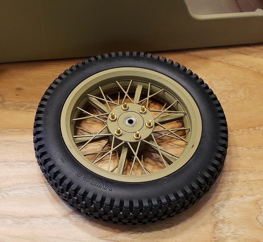

Its not 100% accurate but should be fun to see in RC. I had to modify a couple of the parts- the bearing hole in the wheels was too large for the bearing specified. If you want the STL files for this let me know.

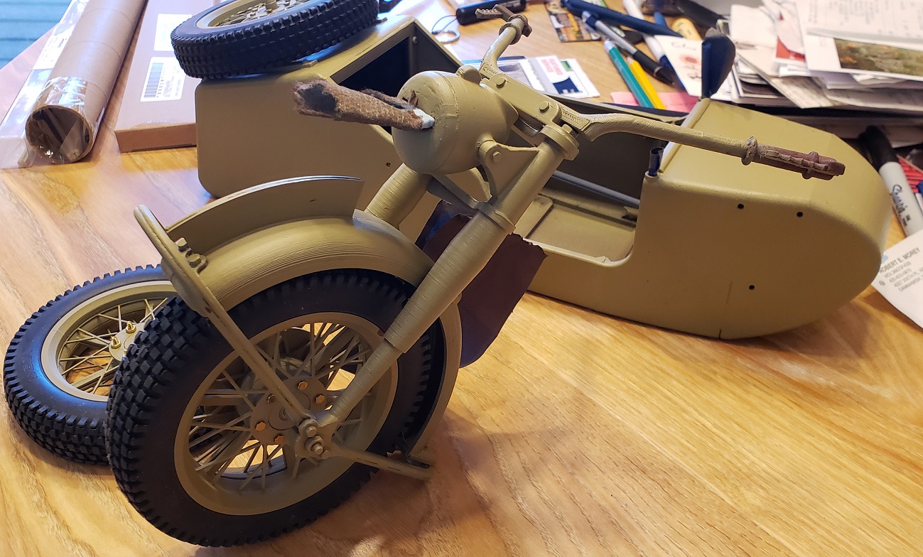

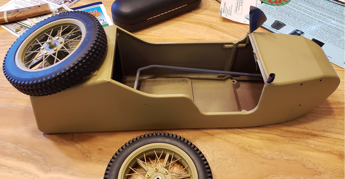

Side car assembly
Side car assembly
Front end assembly
Front end assembly

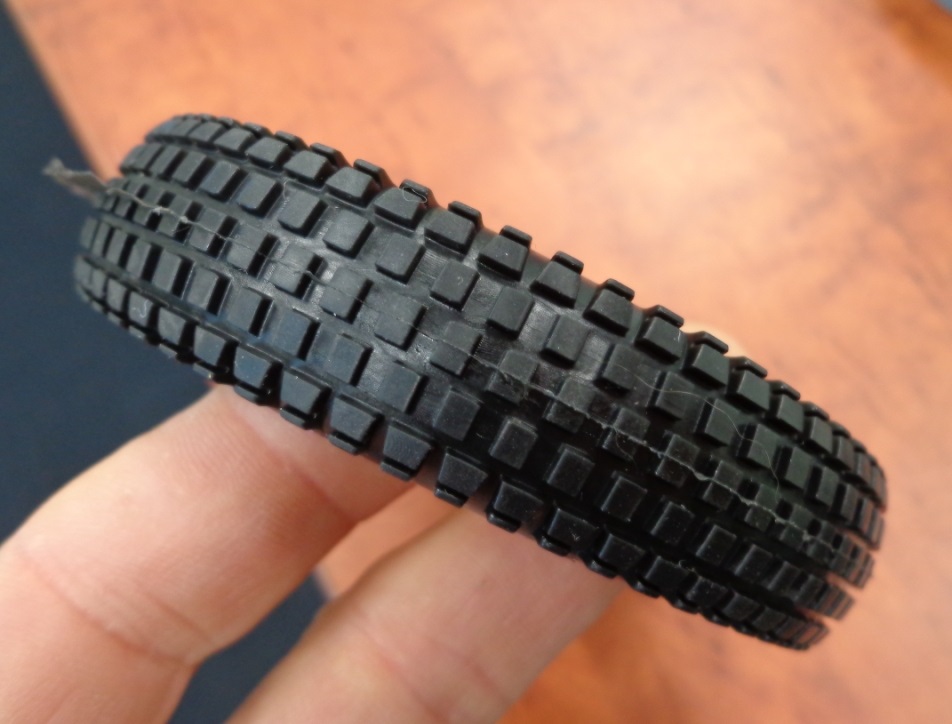

Rubber tire
Rubber tire
Wheel assembly
Wheel assembly

Thanks I was very pleased with how the rubber tires came out. Even printing them in PLA and painting looked pretty good. The spokes are pretty clever - can't take credit for the design. I did have to redo the bearing hole and I made the spokes a little thicker. Thanks for looking.

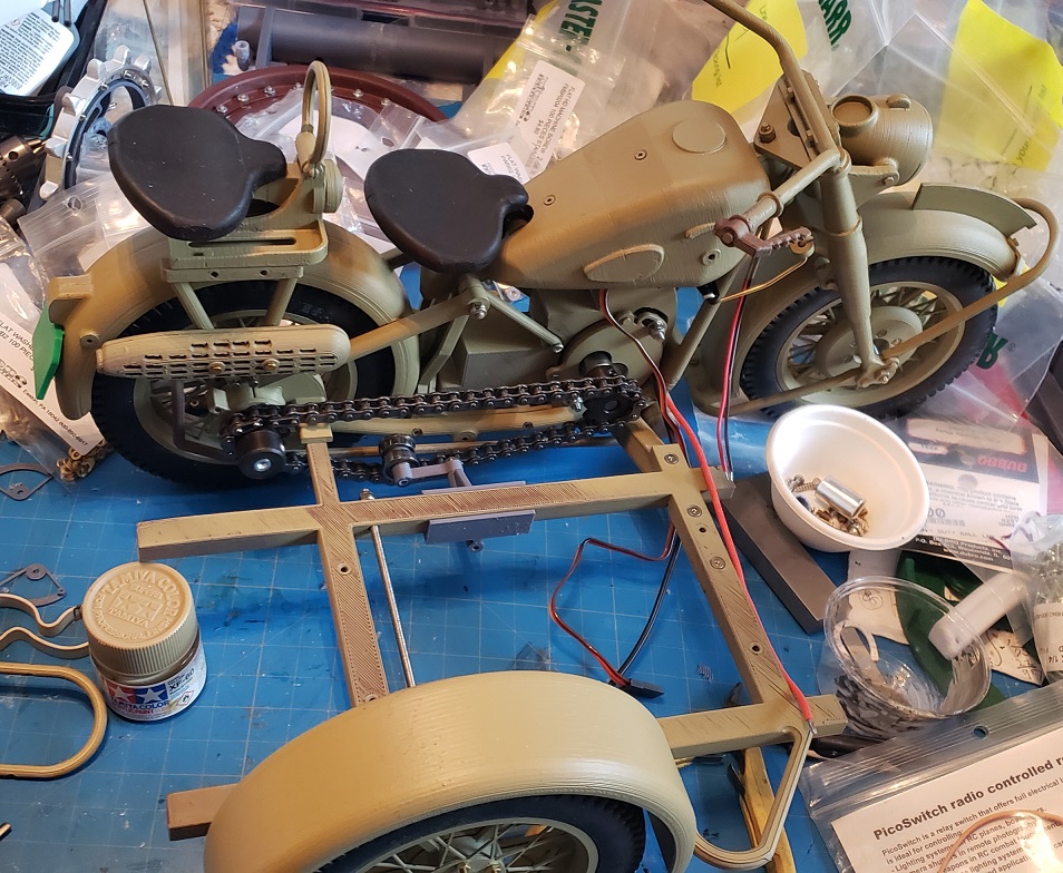

Drive line showing chain and sprocket.
Chain tensioner
Chain tensioner

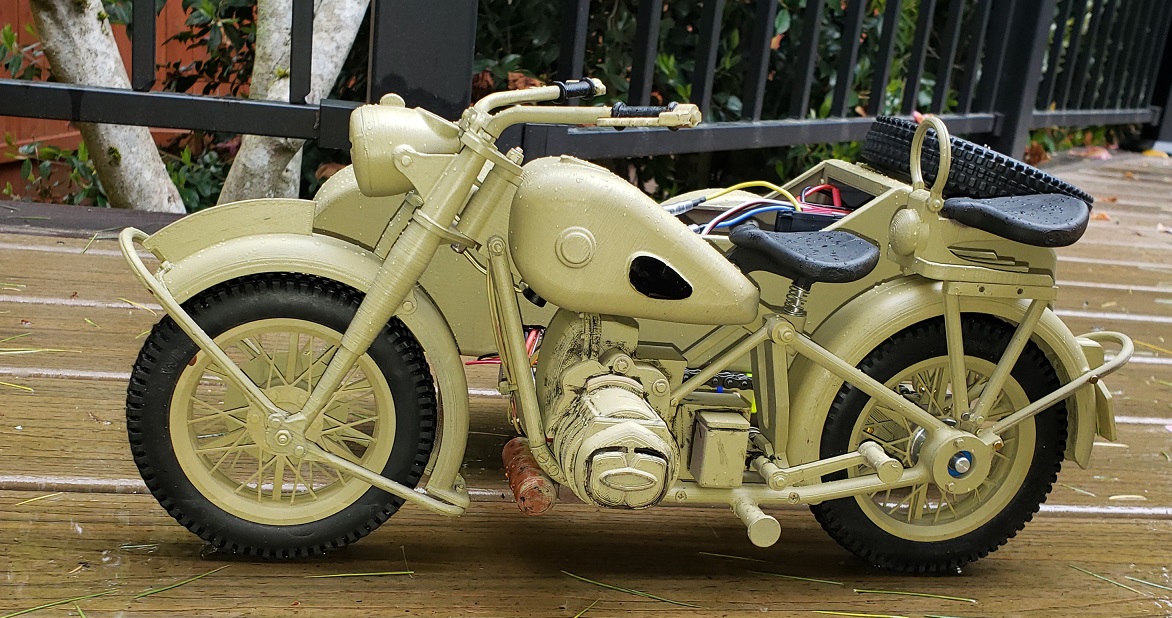

Outside test drive
Outside test drive
Left side - run day.jpg (177.75 KiB) Viewed 3059 times
side view
side view

Aboput the tyres, it seems to me that they are made in a mold, right? not printed with TPU.

I found the motor on ebay. I used the Comodrill motor specified in PDF, but they are from UK, so a bit hard to find. If you absolutely cannot find one I think I buy several spares. The tires someone made for me in rubber, with a multipiece mold using my CAD file. But I print some in PLA and they work great as well.
