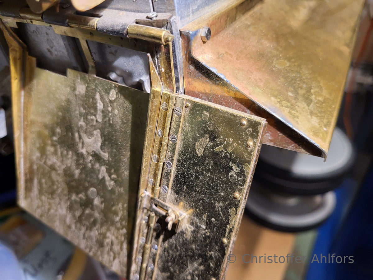

The fixed fender didn't last long: :lol:

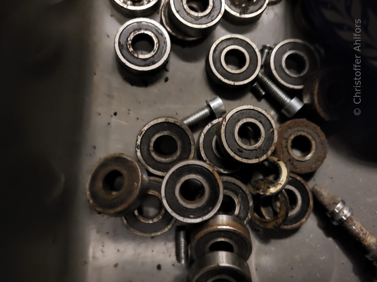

The wheels were disassembled completely and cleaned in the ultrasonic cleaner, together with the hubs:
There were issues removing the bearings initially, but as soon I had disassembled the wheels, they came out of the hubs easily. There were only a handful bearings that were jammed, but I decided to replace them all with new stainless. I'm not looking forward to disassemble all the wheels again anytime soon! :shock: They looked rusty on the outside and the seals got damaged in the removal process. I don't think it's a good idea to glue bearings in place? :roll:

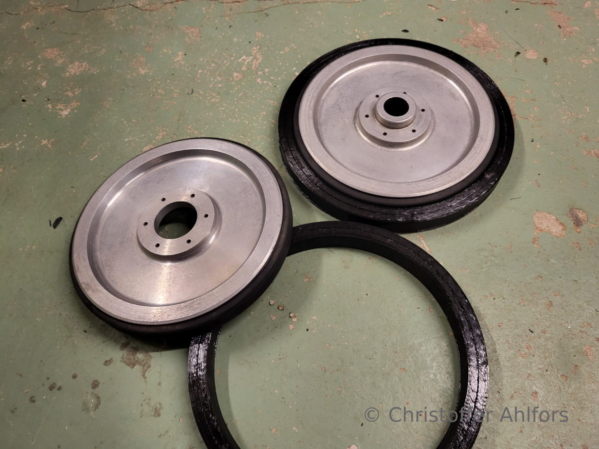

Lots of wheel rings came loose in the cleaning process. None of them had been glued with the black Loctite 480. Some were glued with silicone caulking, which I used initially in 2010, so that's pretty good mileage still. :) Many had been glued with a Loctite allround glue specially designed for metal, rubber, etc. Totally useless! :evil:
As part of regular maintenance, I glue the rings that have come loose with Loctite 480. Eventually, all rings should be gone through.

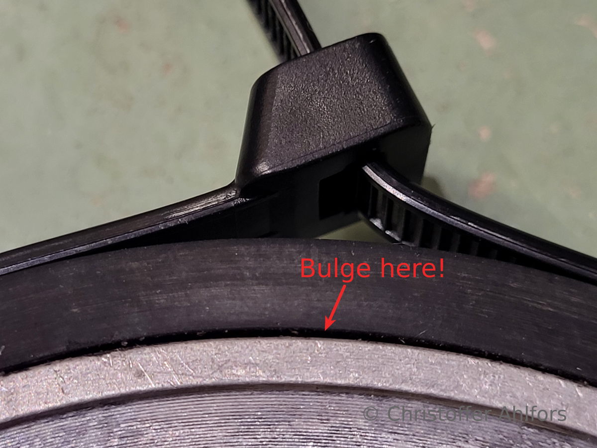

Using ordinary tie straps produces a bulge on the rings, where they don't quite stick. This looks ugly and is a problem that might spread when driving:
To avoid this problem, I used this method using 3D-printed rings that the wheels are pressed into while curing, suggested by MrTyko here on the forum. He hasn't dared to try it himself yet, but I can report that it works very well, indeed:

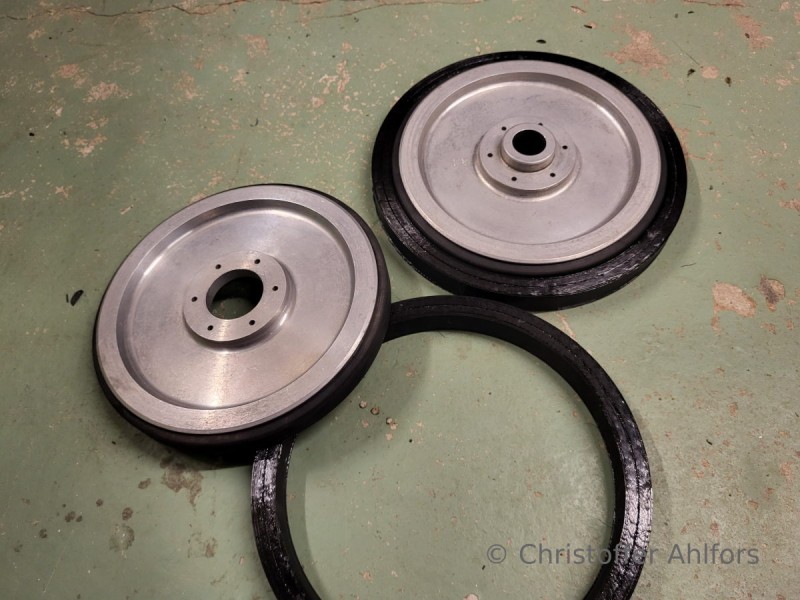

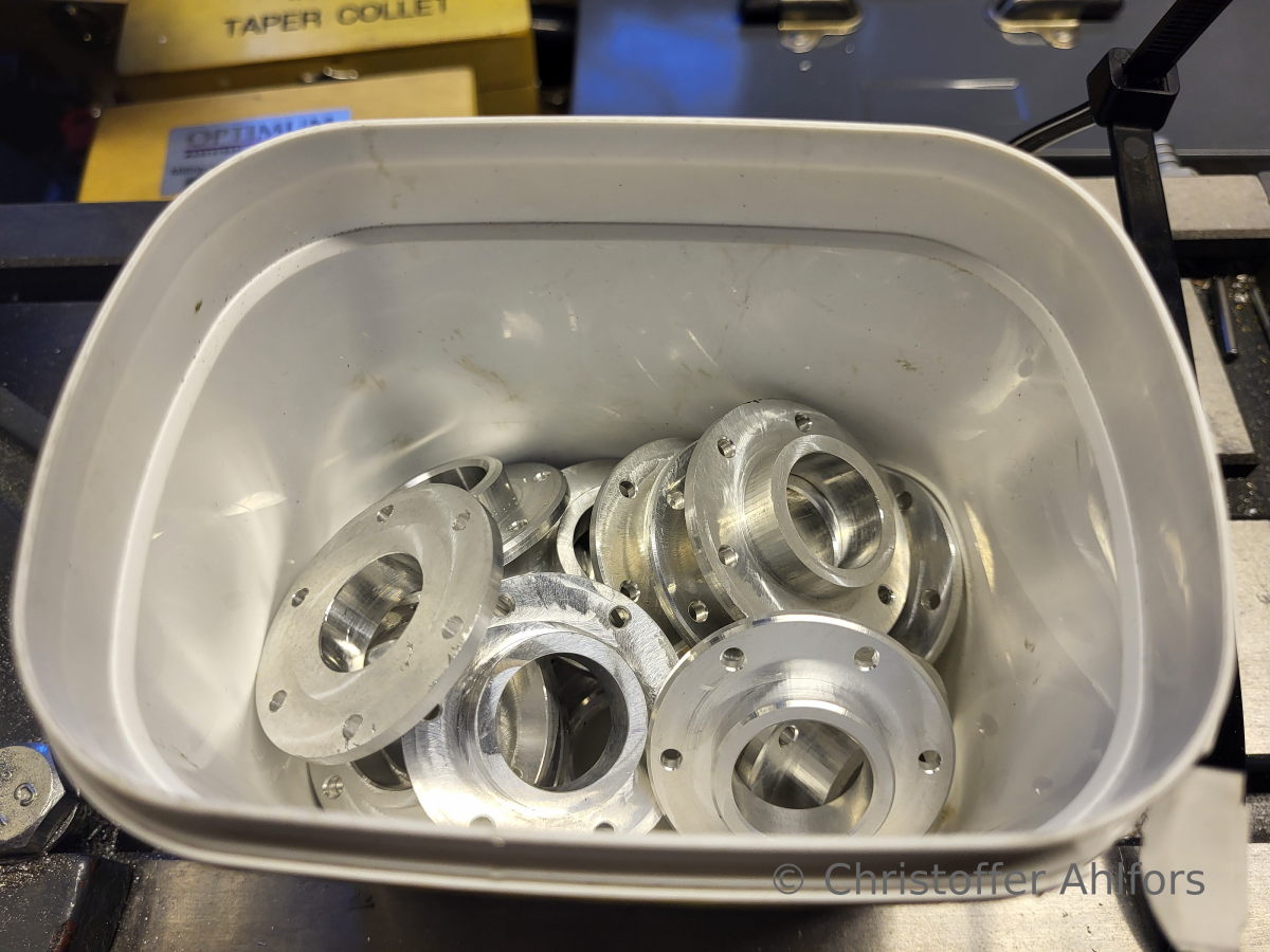

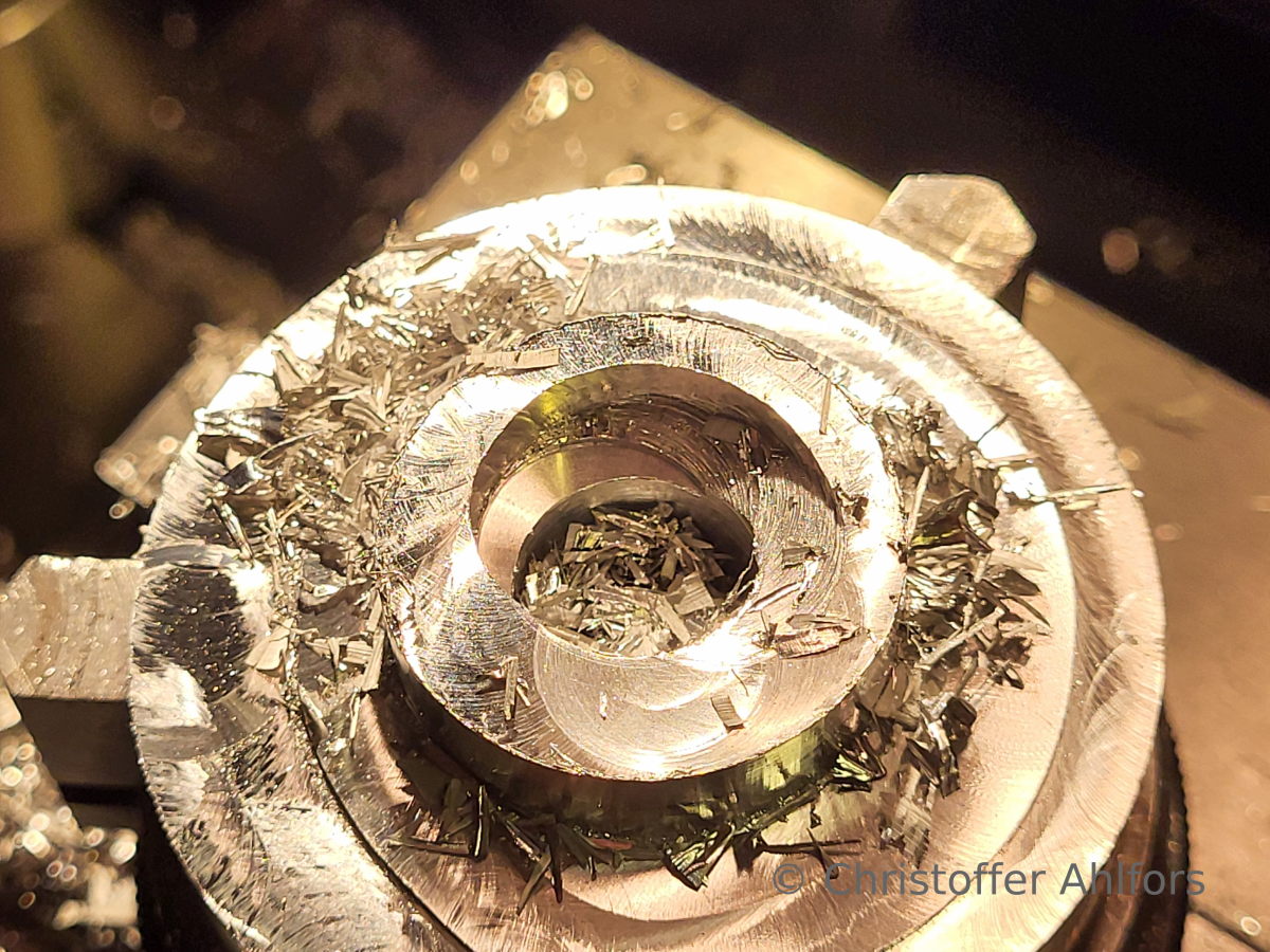

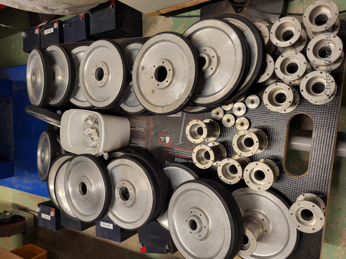

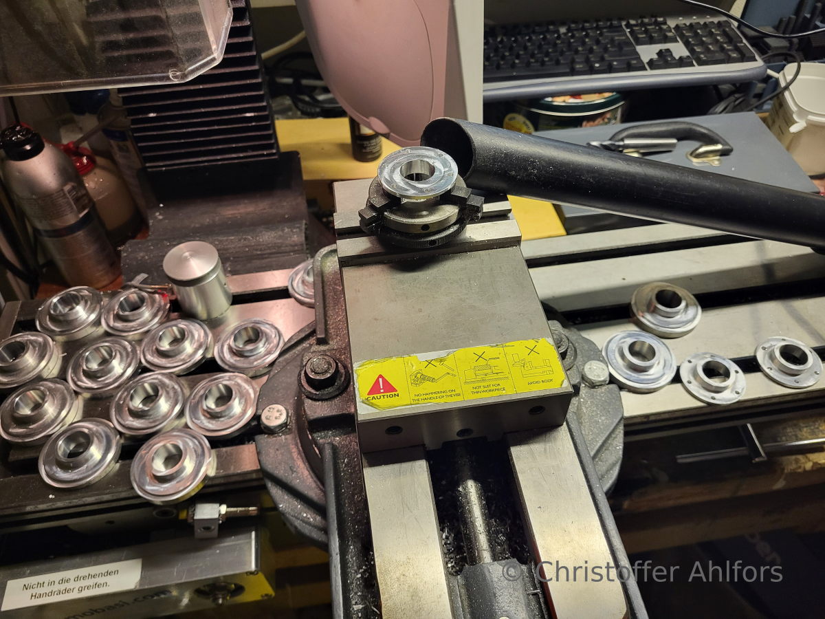

I have been working very diligently making new parts for the running gear:
The hole is drilled and milled up in a helix to the proper size:
Parts in process:
Finished parts:
But, what is it? :roll:

Chris whatever they are they look really good! wheel spacer?

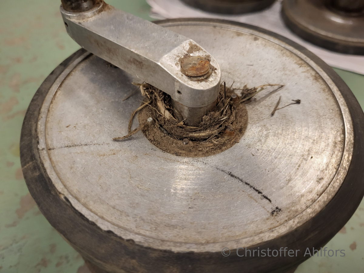

You remember the mess in the wheels:

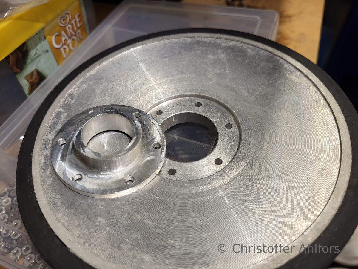

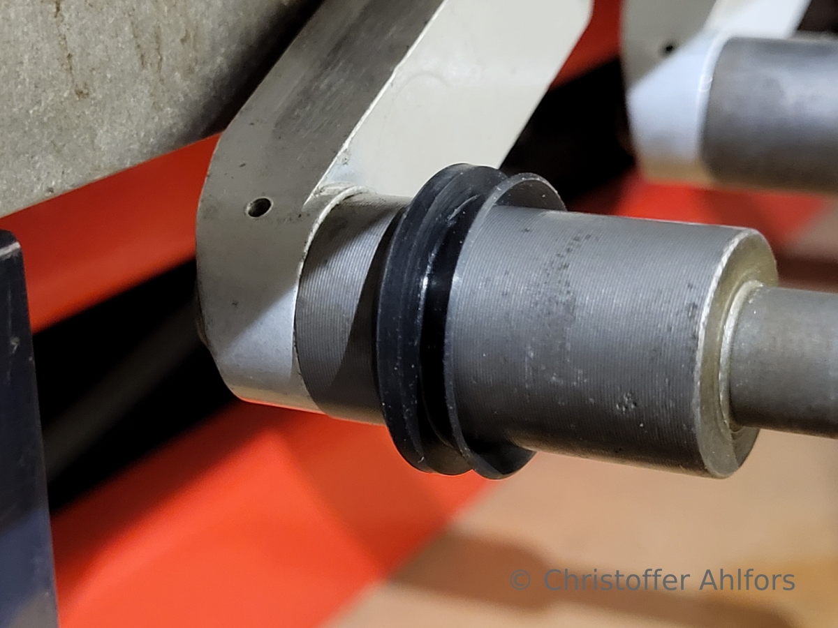

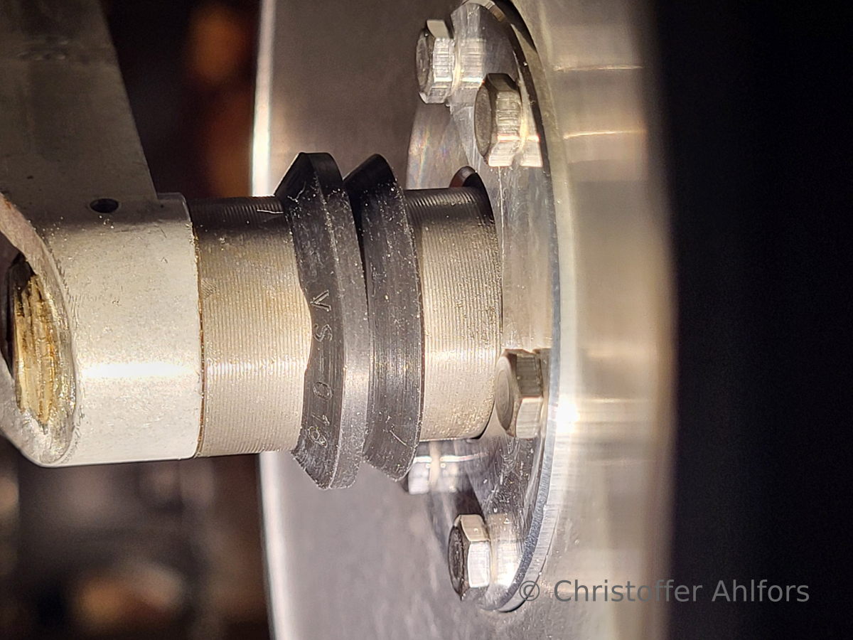

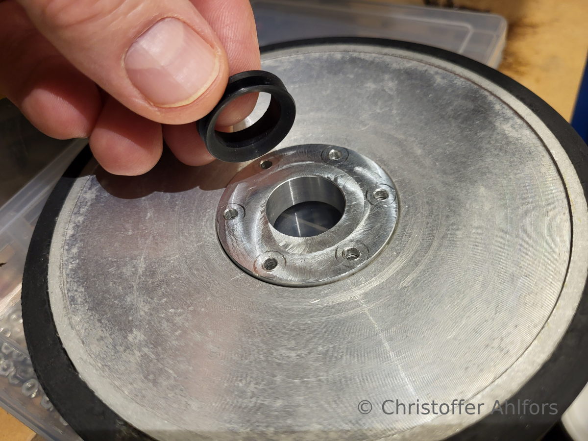

The plan now is to prevent that in the future and that's where the new parts come in. They are flanges to sit on the rear of the wheels:

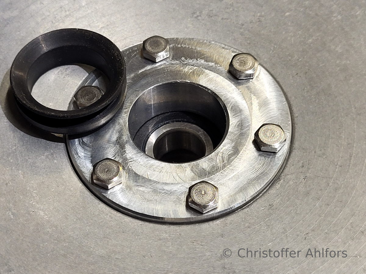

A rubber "V-ring" and the flange will work together:
The V-ring will sit on the shaft:

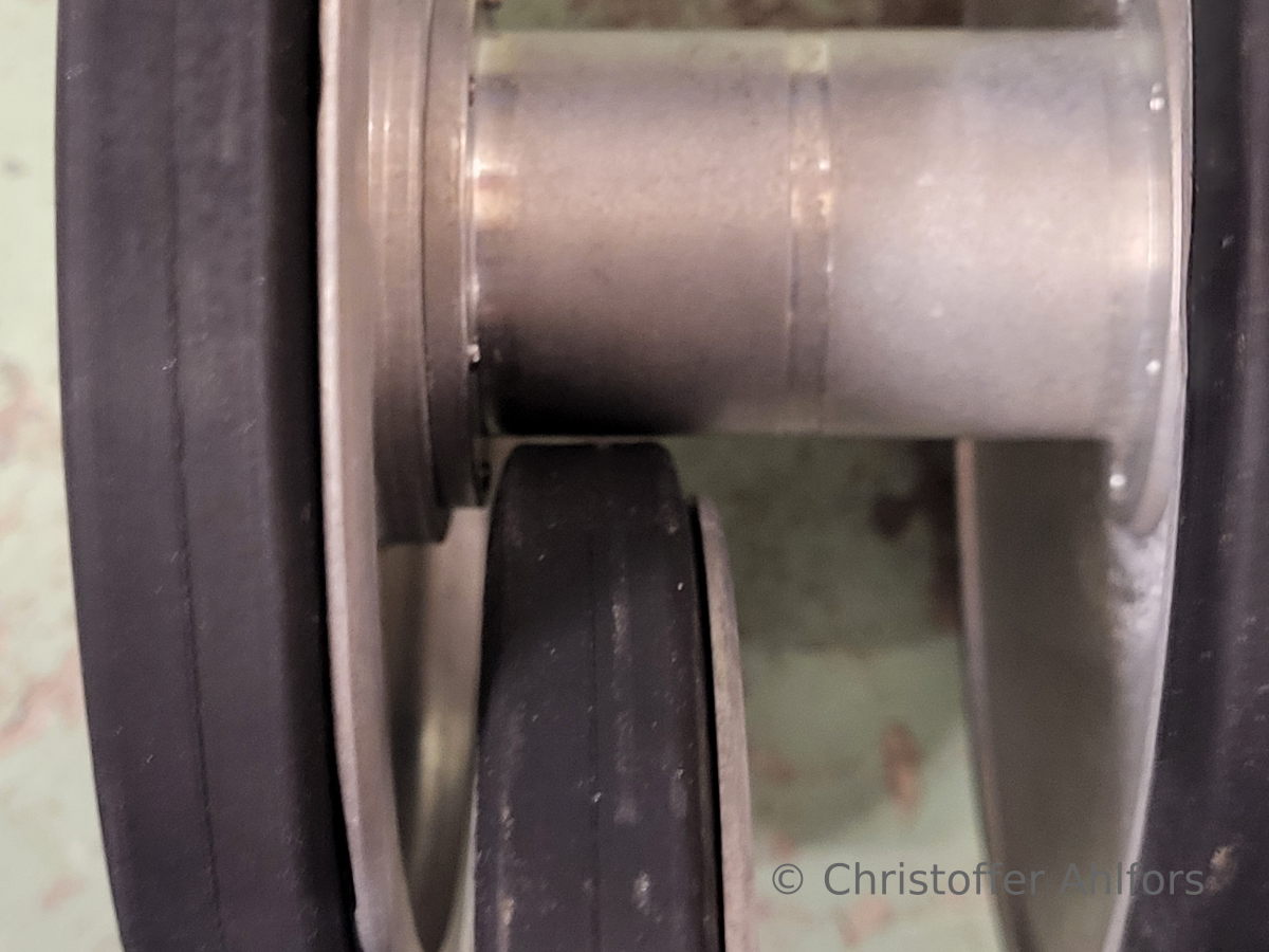

The wheel with its new flange installed on the shaft and moved toward the V-ring:

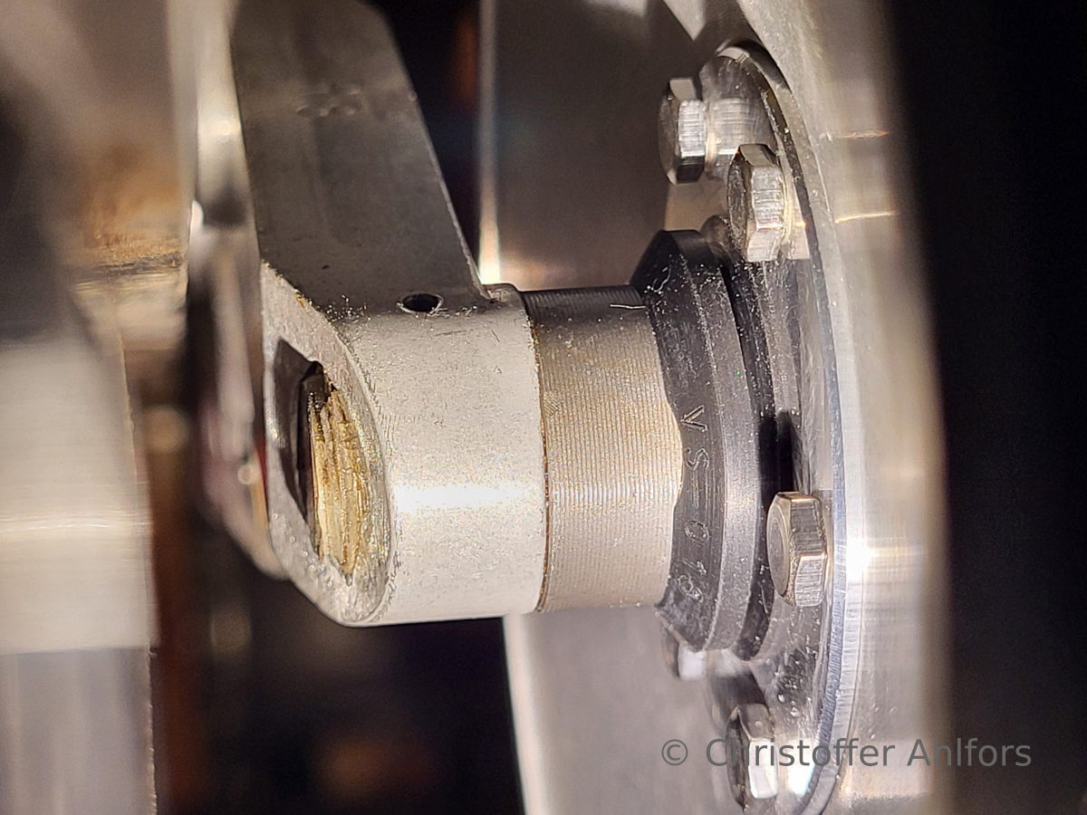

The wheel in its proper position and the V-ring sealing against the flange:
This ought to protect the inner bearings well. The outer ones are still vulnerable, but experience shows that the far biggest problem is on the inside.
All I need to do now is to give the wheels a final cleaning, a clear coat and start assembling! :lol:

That's cool Christopher. I think it will help.
Looks like just adding the metal part without the seal wouldl help keep out debris due to tighter fit on axle. With seal even better.

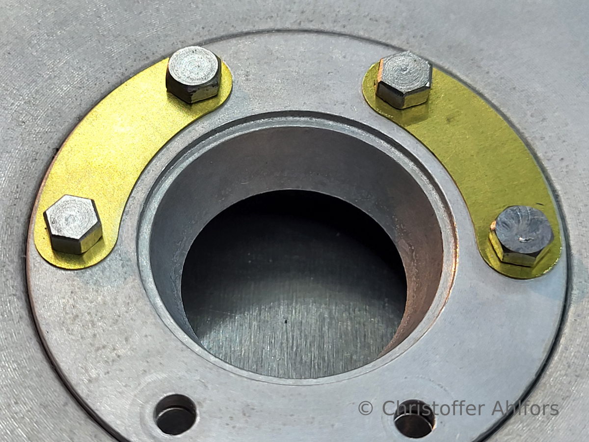

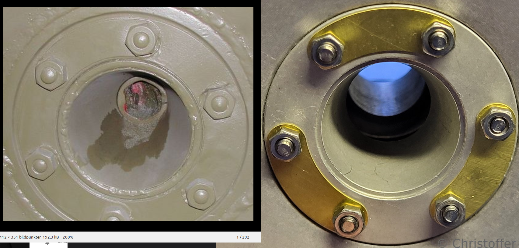

I am currently struggling with the size of wheel screws and nuts. Every other wheel has screw heads and the other nuts visible and it appears that they are supposed to be different size. I didn't see that coming... :shock:

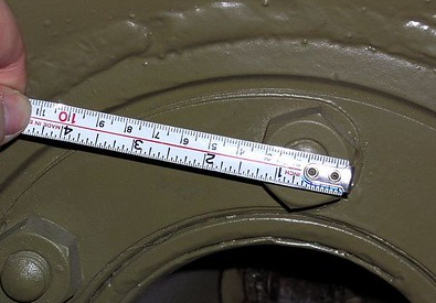

I assumed the screw heads would be the same size:
It seems that they are around 27mm, resulting in a s/w of 4,5mm on the model. The ones I bought are 5,3mm, which matches the 32mm on the real thing. I have been unable to find suitable replacements, especially since I have already tapped M3. BA could have been an option, but now I need to invent some. :lol:
After gradual development, I came up with the one on the far right. In chronological order: 1) 4,27mm first try, 3) 4,5mm with hexagonal chamfer 2) 4,5mm with circular chamfer, and 4) 4,5mm thinned and circular chamfer.
It's a reasonably quick process. 48 plus spares to do. :D

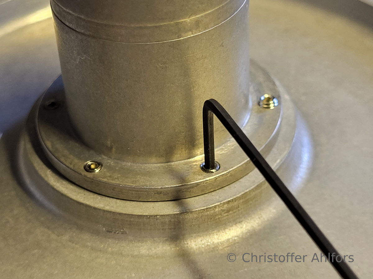

MrTyko suggested to use grub screws instead. The nifty thing with that, is that the length can be adjusted so that they stick out just the right amount from the nuts:
