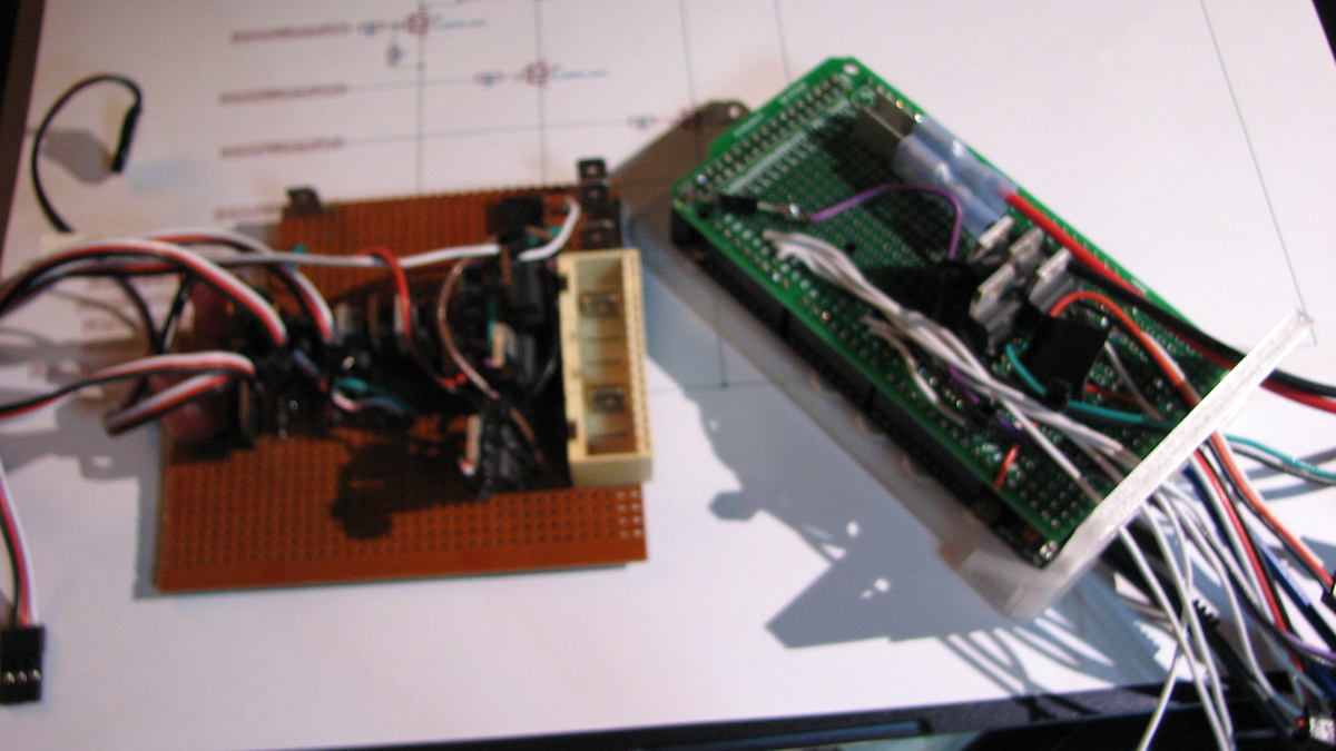

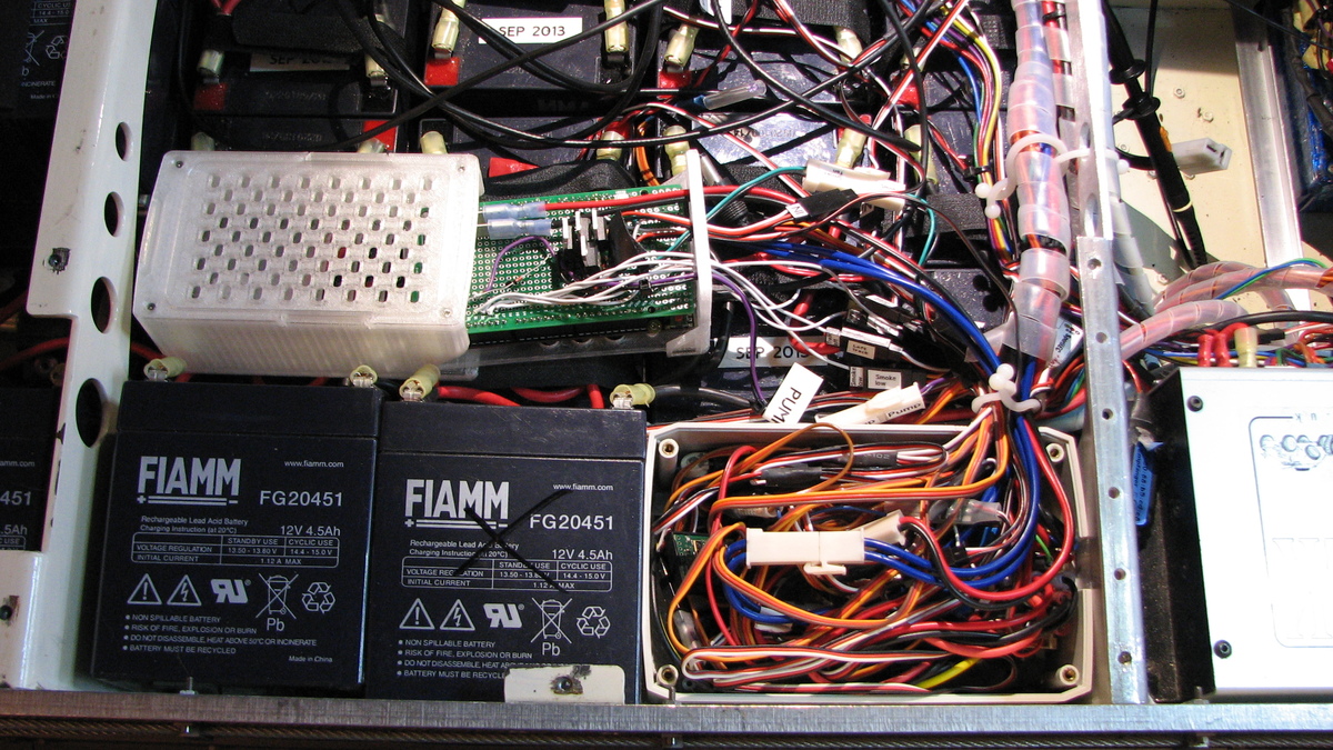

I have been busy on multiple fronts, as usual. The one that has progress to show is the replacement of the discrete electronics (that replaced the old relay stuff some years ago) with an Arduino Mega controller.
This mess:
is now replaced by this very tidy installation:
Er, well. Hm. :eh:
Anyway, what I did was to replace the board on the left with its ten or twelve MosFETs and Benedini smoke controller with the Arduino Mega with only four MosFETs on the right; one for each item to be controlled. Pls excuse the blurry picture:
The big thing is that everything is now completely configurable in software! :thumbup:
However, the number of wires is still a problem... :wtf: Will need to do a bit of thinking!
Cheers!
