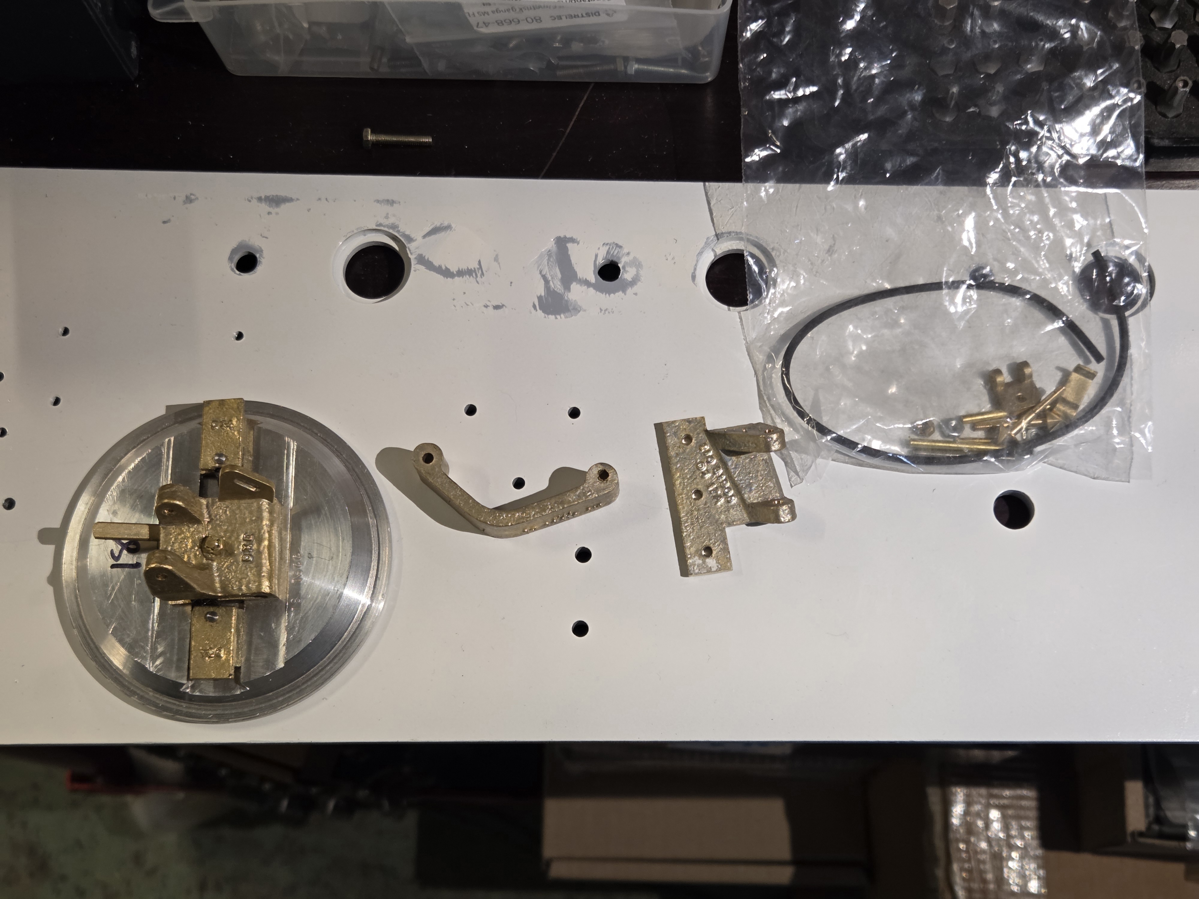

This beautiful turret escape hatch arrived in the past week:
