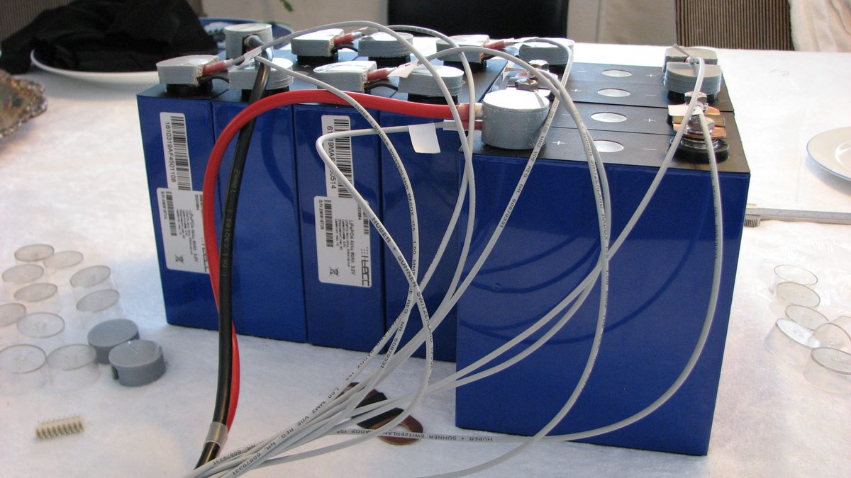

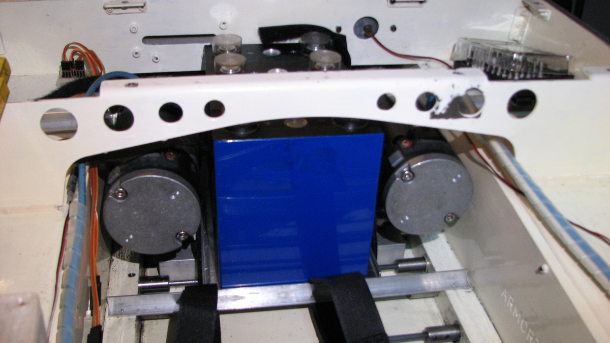

After some challenges, I have finally managed to get a set of suitable lithium batteries. Installing them will be the next project in line.
There is one wire to each cell for the balancing circuit.

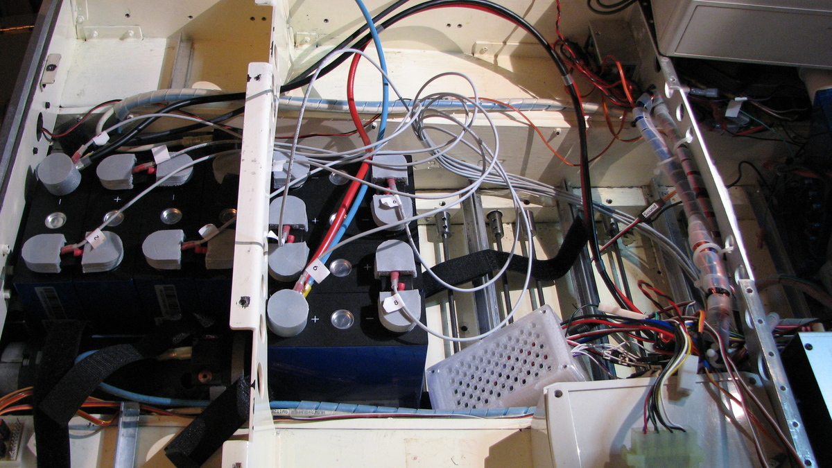

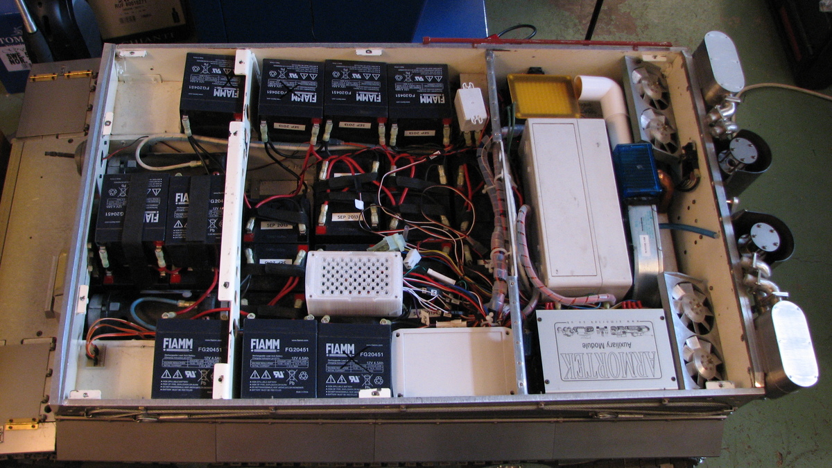

Here is the "before" picture:
Wonder if this is really going to work? :eh:
Hesitating to take the plunge! :oops:

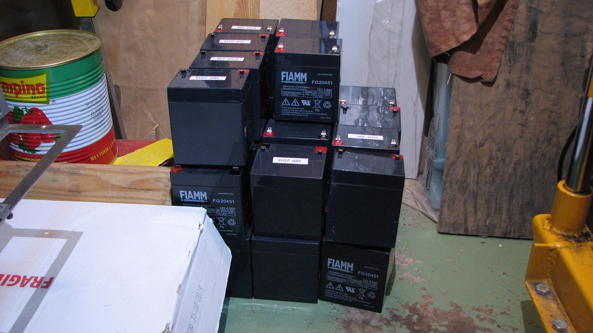

Batteries removed:
80 kg worth of lead. How am I going to do without it? :lol:

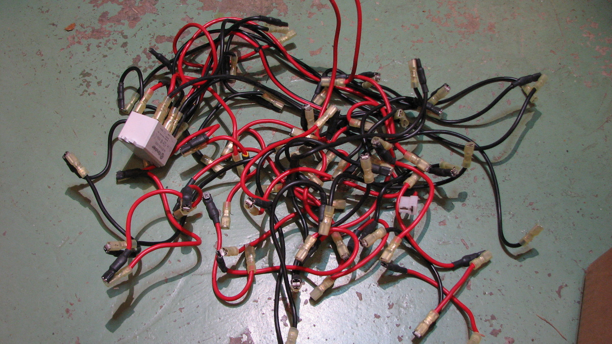

And the wiring nes.... eh... erm... loom:

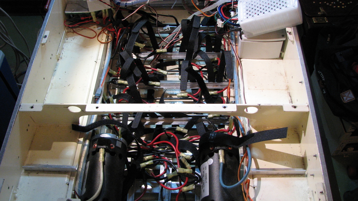

Battery rails need to be moved. Installation in progress:

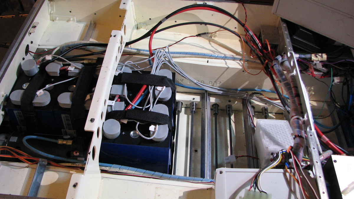

It all fits!
The finished installation echoes of emptiness:
It will be interesting to see how 9 kg lithium will stand up to 80 kg lead capacitywise... :shock:

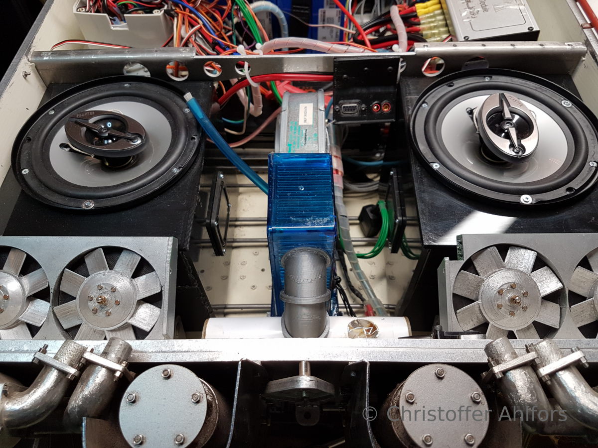

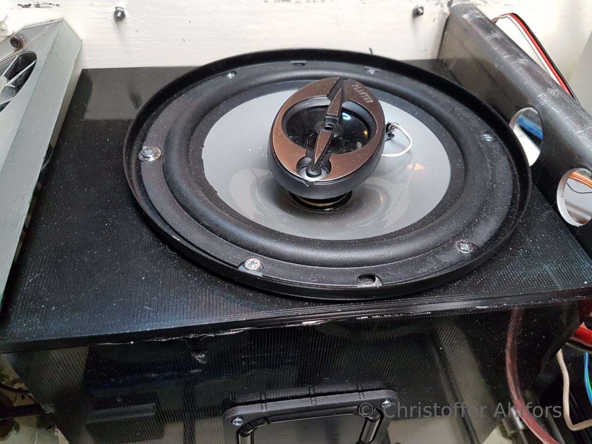

The fire simulation has indeed had to go in favor of better loudspeakers. These are 3D printed according to mrTyko's recipe. He was also kind enough to donate the bass membranes. The speakers are still work in progress (leaking), as I am still working on the basics (making the sound system work properly).

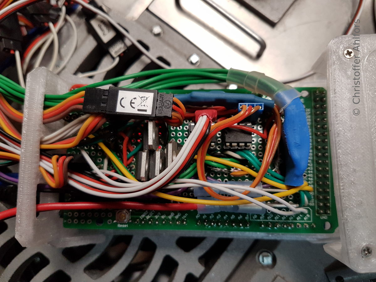

It DOES work, however. I am currently occupied with the volume control, using a digital potentiometer in the Arduino controller, rather than a small analog potentiometer sitting on top of a servo, that I am currently using. I am an electrical engineer, so a digital potentiometer is the proper way for me. A mechanical engineer would probably choose gears and levers. Oh, and grease! :lol:

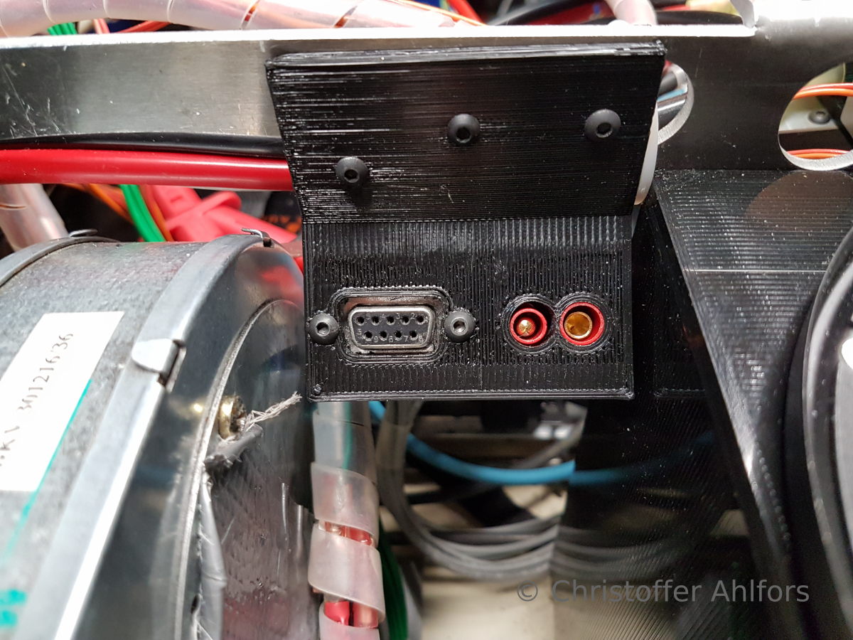

I made this small panel to hold my charging connectors.
MUCH better than fumbling after loose ends!

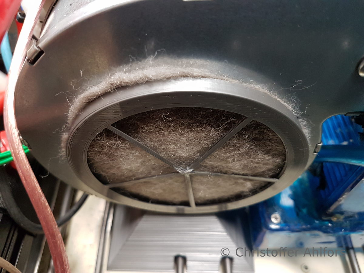

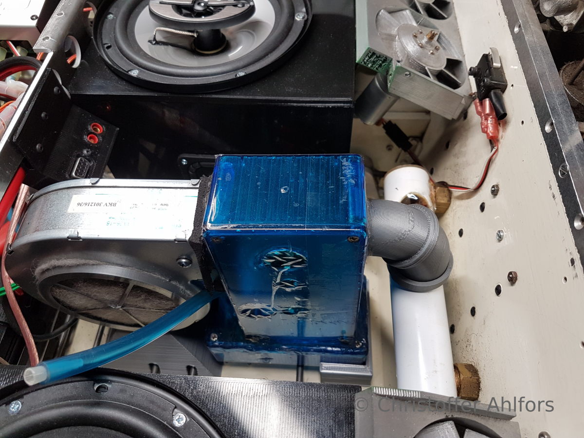

The smoke unit needed relocating with the new speakers in place and is now mounted lengthwise in the hull. I printed a few steady supports, so it does not fall over, and a filter holder. The filter prevents blowing dirt into the delicate smoke generators. In all, a MUCH tidier installation than before.
There was not room for the commercial pvc tubing, so I tried to print my own. It took a while to get everything correct, but it fits, has a smooth airflow, is easy to remove the smoke unit and I did not have to go out to shop for parts! Yay! :D
The visible gray tubing is PLA and the connector down to the white PVC tube is printed in flexible polyester (FPE). This makes the smoker easy to connect/disconnect while not leaking. What looks like clear tape, is indeed clear tape. It is there to cover old holes. It has worked well in the past, so may well be an almost permanent solution. If I revisit any of the parts, I will redo them without the unneeded holes, of course. :angel:
Here is a view from behind showing the entire layout:
Although not perfect, it is a LOT tidier than before!

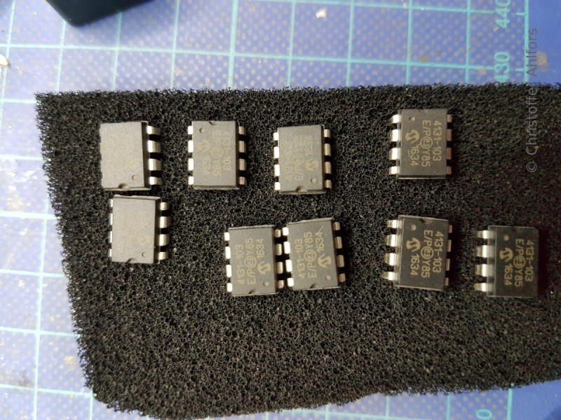

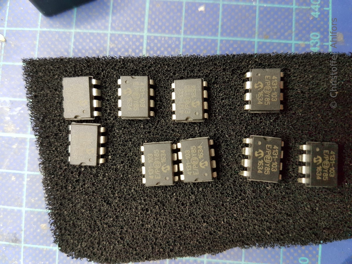

A digital potentiometer is a small IC. I bought a bunch for the future, in case it would be a success. Unfortunately, these are no longer available.

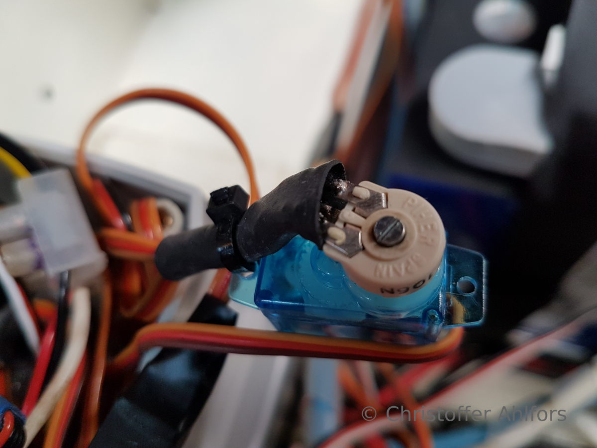

The old Flintstones type solution with a potentiometer on top of a servo, was unreliable. Of course, if you do it right, it will work too. This is how not to do it:
To the right, you can see one under the wires of the Arduino prototype board (yes, there are more of them):
It took a while to get it all sorted, but it works! :D
I can now control the volume on the transmitter, without any analog devices that can foul things up. Not necessary, but I wanted to try it.
